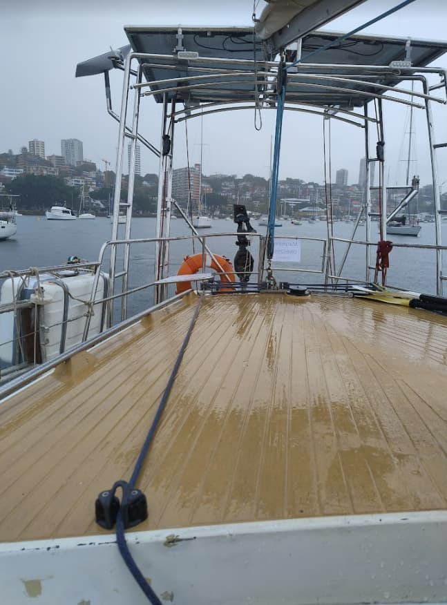

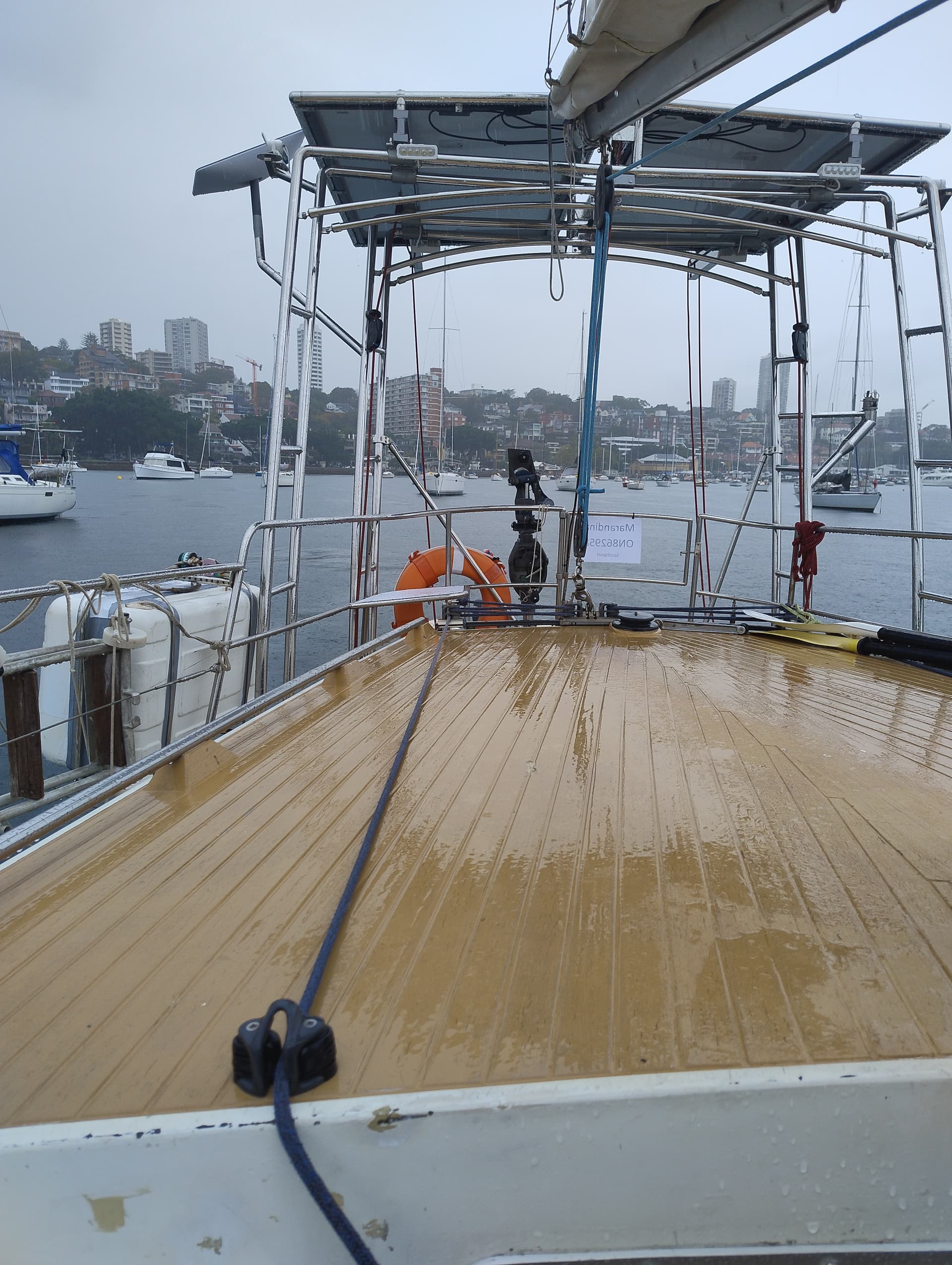

Thanks Chris, I was trying to avoid having control lines coming back on the roof. Could I trouble you to post a picture of your arrangement? I have not moved forward on this project yet. Thank you. Philippe
Hi Philip, here is a picture, if I was to install it I would lead the control line right up against the inboard side of the hand rail rather than where it is on our boat. When reaching it is an often used control as having the car to far to windward can cause the boat to need more rudder angle, and moving down the track often corrects this. Chris
Thanks a lot. Indeed this might be easier to control than what I had in mind. Too bad this was not integrated at construction running in the hand rail!
